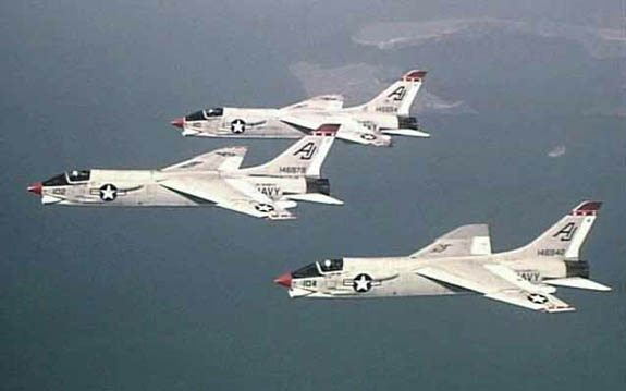

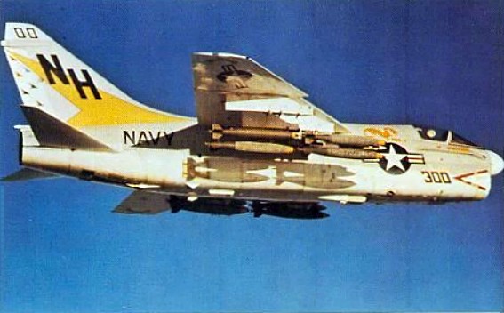

If they were really that concerned about reducing the risks of having the pilot eject, they would have built the thing with a second engine![]()
Yeah...just like these pieces of shit...
Yes, horrible-all of them.Yeah...just like these pieces of shit...
