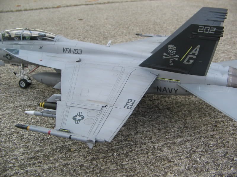

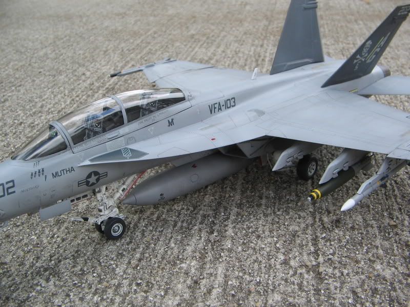

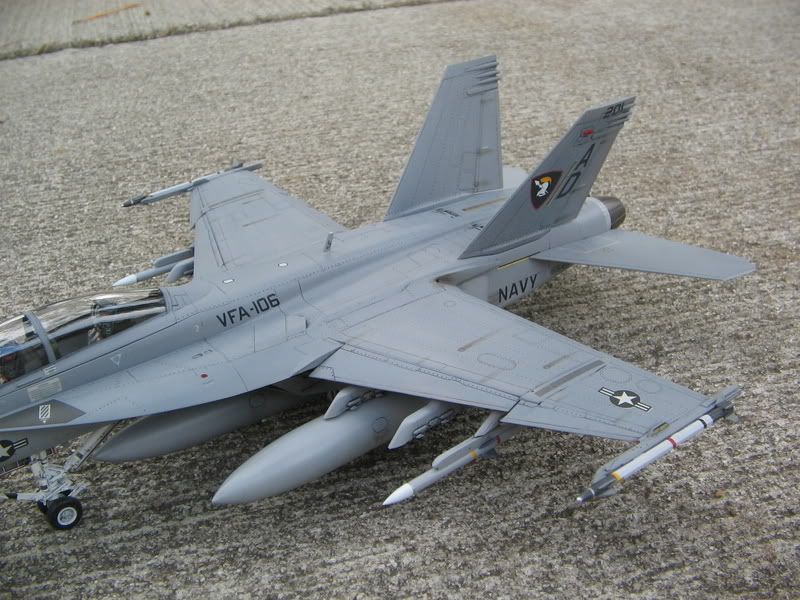

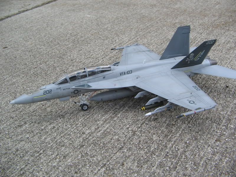

Here are a few pictures of the other two I have done.

Excellent stuff. One thing I was going to note. I noticed red stripes on the propulsion section of the missiles. Those would actually be brown. Just something for future reference. Also, you have an extra stripe on there that I'm not sure would be on it. The black one aft of the red stripe. Also noticed on the 103 bird that you have a yellow w/ a blue stripe. You would never see that. It would either be all blue stripes, or yellow w/ a brown. Blue stripes indicate inert ordnance, ie. no bang. Great models though, wish I had the patience and skill to do that, not to mention the time.
Note, those stripes are simply used to identify the class of ordnance. Yellow being class one, think big bang. While the brown is a class three, thing propulsion.

Thank you for all the wealth of information. The bands have always been confusing to me. The 103 and 106 birds I copied form other models and were my first two. I knew they were most likely inaccurate. The 213 jet I had pictures sent from the boat. I used a yellow and black band. The pictures were not the best. By what you are saying it looks like it should be yellow and brown.
Google images can be your best friend or worst enemy.
Thanks again. I have time to correct this for him before he gets back.

If you're going for realism ever w/blue tubes, be sure and put lots of silver scratches on the blue body as they are typically beat to hell. I'm a professional when it comes to inert ordinance, that is all.

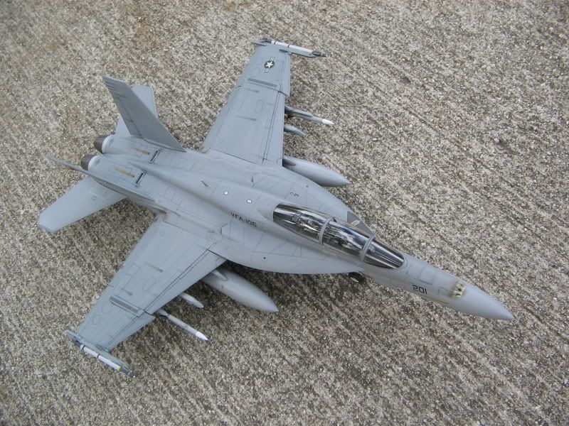

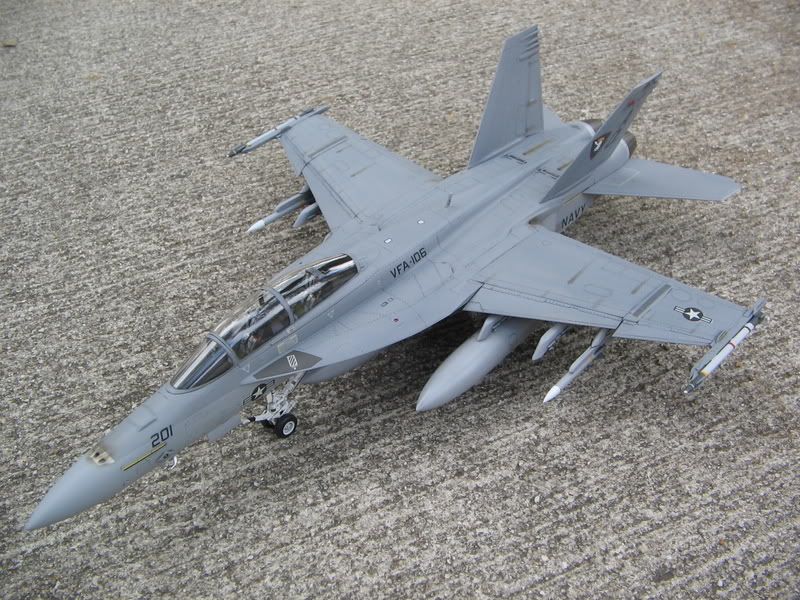

Your Rhino's look great! What aftermarket cockpit did you use? Is the kit itself the Hasegawa kit or a different kit? What did you use to raise the panel lines? The only recommendation I would make is that the displays on the insturment panels are only green when they are powered up. Gloss black would be better or some flat black and a little Future wax. I hope my Rhino turns out just as good.

Well, the kits that came out the best IMO are the 103 & 213 birds. They are both the F/A-18F Revell kit. I didn't use any aftermarket accessories except the decals. The 106 bird is the high dollar Hasegawa kit. Unless you are looking for a kit with flaps the can be dropped the Revell is a much nicer kit for the money. The Revell kit has a great cockpit and ejection seats. The Has kit is fairly bland. Also, the Revell has great landing gear and armarment. I thinkt think the drop tanks are much more accurate vs. the Has kit. I don't think you can go wrong with the $25 Revell kit. A nice paint job, aftermarket decals, and some weathering really do it justice.
The Revell as well as the Has kit has recessed panel lines. I only rescribed panel lines where I sanded. I used the ProModeller Dark wash to bring out the lines. Just brush it on and let sit 20 minutes and wipe of with a soft cloth until you take off the right amount to give you the desired look.
Thanks for the gouge on the cockpit displays. I have seen them done so many ways. Mostly I see green, in models, the actuall A/C appears more black. I did the 103 bird with black and I do think it is a better look.:)
