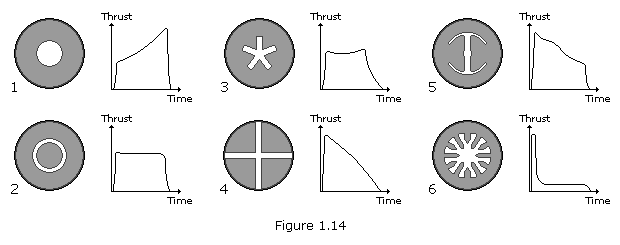

Edit: OK watching the re-plays, I'm a little curious. Maybe someone really knows their rockets here. Just as they were passing through the Mach (as shown by the vapor rings), the guy said the chamber pressure was decreasing as designed. I understand they might want to decrease chamber pressure and thrust passing through max-q, but how do they design a solid rocket motor to do that?
Solid fuel rockets can be designed with specific patterns to affect the surface area being burned. More area = more burn = more thrust. Create a shape that decreases the area at a certain time and you'll decrease the thrust and all that with it.
	A picture is worth a thousand words, this should explain it...
picture worth thousand words follows...
