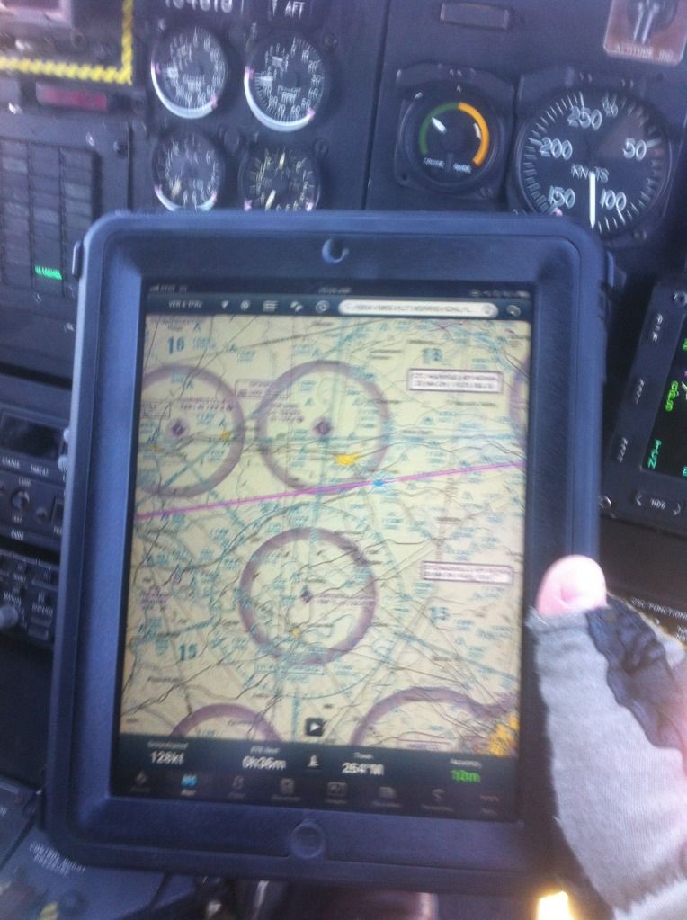

After taking it out to Yuma/29 Palms I can answer some of your questions...
-Will the iPad survive in the greenhouse known as a helicopter cockpit when the OAT is +50°C?
Yes and no. If it gets too hot, it shuts itself off and you have to wait until it cools down. I saw 42 on the OAT, and as long as I kept it out of the sun, turned it on, referenced it, and turned it off (kinda like pulling a chart out, looking at it and putting it back in the map case), it was fine.
-Will the iPad survive in salt/sand/dust/rain/etc.?
Sand and dust, I got a bunch of it landing in the unprepared zones in both 29 Palms and Yuma, no problems. Rain/salt? Don't know - but if it's an iPad 2 or the next gen iPad, there are cases that are 100% waterproof.

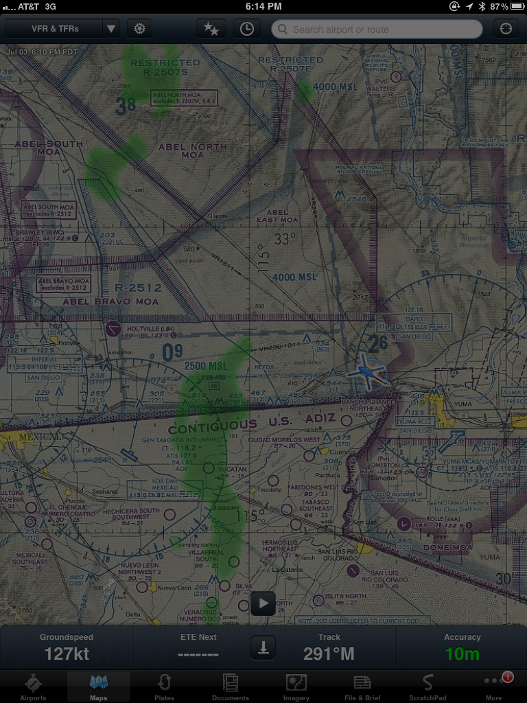

-Is it NVD compatible?
They make an NVG compatible screen protector, that is not cheap. However, I tested mine with goggles and with the screen brightness turned down it was fine.
-Is it Marine-proof?
If you get a rugged case (like the lifeproof that is also water/sand/dust/snow/shock proof)
-What happens if I have to spend multiple days in the aircraft? Is there a way to charge the batteries?
Here's something I did not know about the Phrog. There's a way to plug into the aircraft's electrical and get 110 volt AC. Found this out from one of our pilots that was at HMX at one point, and he said they used it all the time.
-What happens when (not if) it fails? Do I bring a spare, or do I honi my okole goodbye?
I brought a full pubs bag with me for the CCX, and used my personal Nav bag when we were in Yuma. Didn't touch either (except for a PCL) the entire time. If we were to go 100% paperless, my bet would be that you would bring a spare iPad.

This is the screen shot just outside Pilot's Knob, after I turned the brightness down. No impact to the goggles that me or my copilot could see...
