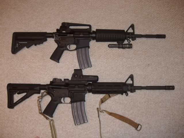

I added some pics that might help you visualize different barrel configurations.....
M4 barrels. Top one is 14.5in and bottom is 16in
Pencil thin barrels. Top is 16in and bottom is 14.5in
The top one is a 16in mid lenght gas system (with a 9in rail) and the bottom is a 16in carbine length gas system

As you can tell by the pics I posted I like Magpul's MOE handguards. They are light, inexpensive and let me mount a light and vert grip in almost any position. There is some real innovative thinking going on in the black rifle world right now.

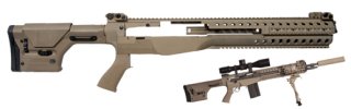

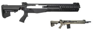

Cron
Yankee Uniform Tango
Bevo16
The sombitch is heavy enough as it is. And for the pricetag on those stocks, I can have a fully outfitted AR-15.
