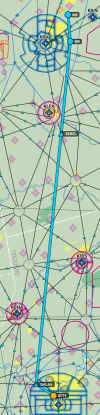

No G-5 in this one?
Why didn't you take the pranged ship? :eek:
ha!
Actually I had just had a top overhaul done on this aircraft (new cylinders) and I needed to put some hours on to break it in properly - that means flying at 70-75% power, staying under 6000 feet DA, and running straight mineral oil in the engine - for the first 25 hours. Round trip to Atlanta and back was only 5.5 hours on the tach. ?
No G-5 on this aircraft - in fact I carry a Stratus unit to plop on the glare shield, paired with iPad/Foreflight for ADS-B IN. Works fine. Old school vacuum AI - and electric KCS-55 HSI like we have in the TH-57 ....
I'll probably just go to an Aspen solution - for under $5K and pull the vacuum system and put the King HSI in one of our older 172's
