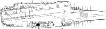

I.e. Air Boss asking V-2 DivO "How long would it take to fix the wires?" hears a reply "Soon", he has an authority to open the deck? Obviously yes. But will he open it? Obviously not, it's so silly. He rather shoot another tanker off the cat or apply to CATCC to divert the poor boys in the air to the shore, right? So we need to improve this damn STOBAR and allow the Air Boss to open the launches even if the landing deck is closed, right? The problem is that tanker Su-33 can be launched with enough fuel for buddy-tanking only from the 3rd position, a sole launching spot with 195 meters of free run on the burner - and this spot's JBD is located just forward of the arresting wires (marked red star on enclosed layout), which of course will prevent V-2 people from making a fast repair there. Fucking STOBAR...Kuznetsov_FD.jpg

V-2 DIVO on our carriers has no real say on the up or down status of the arresting gear and/or catapults. They are more of an administrative (heads and beds) role. That would be the job of the ALRE Bos'n, usually an LDO, who basically runs V-2 maintenance. Air Boss usually won't make a call on the status of gear without hearing from the ALRE Bos'n first.
If LDO means that s/he is former chief who knows everything about the gears and how quickly they could be fixed in reality, it sounds great. Unfortunately here the equivalent of V-2 DivO reports directly to Air DH, and they both are aviation engineers, not the aviators/NFOs and not SWOs, while Air Boss, an aviator, and LSO, an aviator too, are not reporting to Air DH. They all reports to Deputy CO for aviation, who is not running the operations of the carrier, making rather admin duty. Aside of it, an opinion of a man who really knows what it takes to make a repair, usually CPO maritime engineering mech mate (not even EAWS), means nothing untill V-2 DivO makes his own decision. An outcome of this mess is evident - brand new shipborne MiG went to rest on the sea bottom in a good shape...
