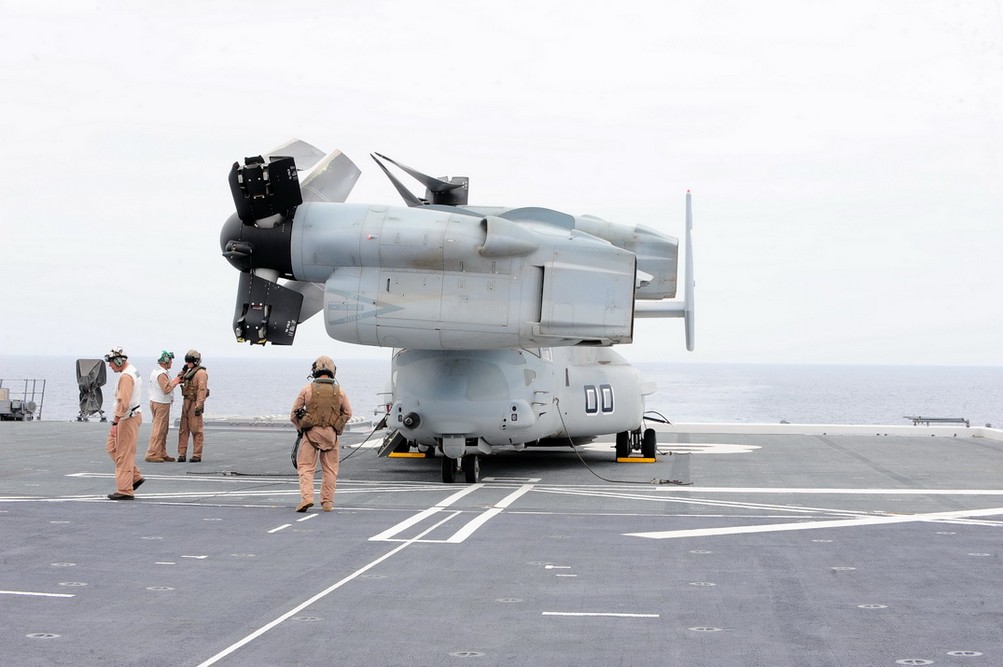

Despite it's ability to contort into downward-facing plopter, and other assorted poses - it's still a really big silhouette on the deck (even bigger in the bay).
Any plopter guys around here know how long it takes this thing to go from contorted to spun up and ready to go?

20 min from spotted to ramps up. It unfolds really quickly.
It can taxi and you don't have to shut it down to offload. Handlers, Air Bosses, and Air OpsOs will just have to learn to deal with it. Will it change the dynamic? Sure. Will it prevent the CVW from doing its mission? Not in the least.

What do you call a quick unfold. Saw it once and thought it was slow.
