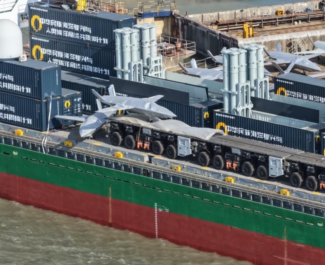

Now they have added EMALs for armed drones on the PRC civilian ships. Easy target?
Zhongda 79, a Chinese merchant vessel, was seen in December 2025 and early January 2026 at Shanghai’s Hudong-Zhudong shipyard receiving numerous containerized armaments, including close-in weapon systems, vertical launching systems and radars. Photo from X
I should go work for the Chinese. At least someone agrees with me that this sort of stuff is a good idea...
