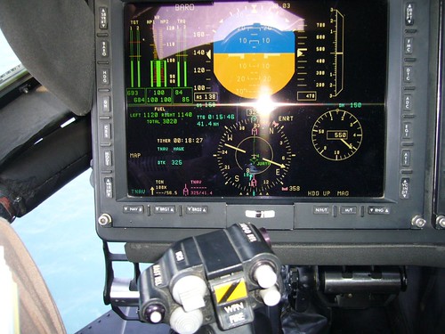

2 questions:
Do you have RAST in a 60S (seeing a RAST REL button)?
Where is youe EMERG REL button.. Your WPN FIRE is where the emergency release for whatevers armed (MAD, Hook, RAST, Hoist) is in the 60B.
N/A
2 questions:
No RAST. So the button doesn't do anything. Our EMERG REL (cargo hook, hoist, or both) is on the right side of the cyclic. You can kind of see the lip surrounding the button underneath the ball. And the switch above the 4 way trim is the WCA/Acknowledge button, I think in the 60B it was the hoist switch.
MasterBates
Yes, that is the hoist switch in the 60B.
Starting at the hoist going clockwise, on a 60B, Hoist, EMERG REL, Cargo Hook, DEPART HOVER, Trim, and RAST (Hauldown Cable) Relase.
AFCS RELEASE and Countermeasre Dispense would be out of sight, along with ICS call.

It's funny how anti-climatic the glass cockpit is. That's basically the same as the legacy cockpits, except they're 2D rather than actually "there" in 3D. I dare say they're even a bit harder to read, just because of the "limited" resolution compared to what a real gauge can give you.
That all said, I bet it's SOOOOO much nicer on goggles.
N/A
In the end, the glass cockpit is nothing special. Just a different way of displaying the same information. I guess when I first got in the sims, it was weird have pixelated gauges, but you end up using the digital readout on them a lot more than the "gauge" itself. Which creates a tendency to gnat's ass it at first, since you now know that you're going 121 KIAS, instead of pretty close to 120.
Pretty seemless on goggles. It looks exactly the same. My only real gripe is that the second nav needle and it's bearing/dme info uses purple as its color. Which is hard to read on a black background at night.
I've heard that some old guys who flew other aircraft for awhile (read: longer than TRACOM) have problems with it causing vertigo more than steam gauges. For whatever reason, Sierra only guys don't seem to have this problem.

how is the glare on the glass cockpits? granted anything with a glass cover is going to reflect light, but it seems at least the configuration of the traditional cockpit with multiple individual gauges allows glare to be broken up a little bit...
...not that i have a real need to be concerned, i'm going to the -60B :D
Interesting, I wonder why that is. Maybe because you see movement better out of the corner of the eye w/ a more crisp instrument, unlike steam gauges, which kind of "go away" when you don't want to see info from one.
I was wondering that too. Depending on how old the MPD was on the Bravo, there were some times when I had to shield the screen w/ my hand from the sun to actually read it. Rare, but it would happen.
Not bad at all, due to the absurdly large glare shields. Unfortunately, those glare shields plus the nose-high hover attitude gives a poor sight picture in the hover.
This is pure wanking. They (ex-46 drivers) said that lack of 3-d AI and pitch bias was causing this. None of the guys who flew legacy -60 helos had a problem. Kinda the same crap as how the inadvertant load releases were caused by EMI.....
