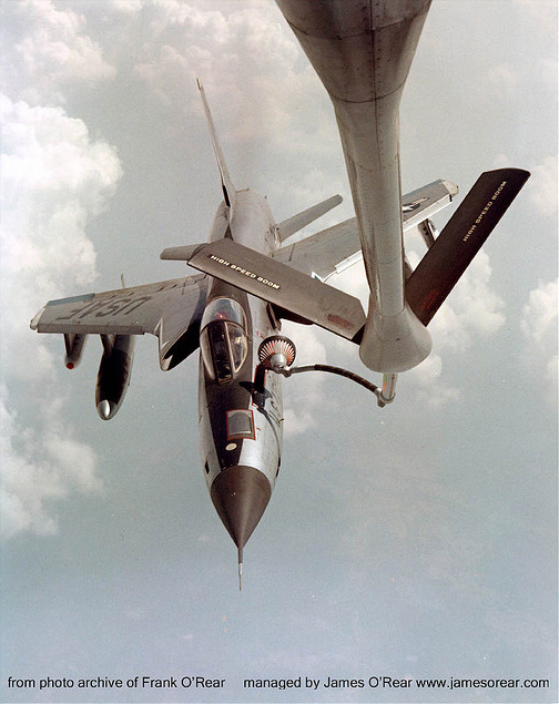

Just FYI, F-105 Thunderchief was equipped with both types of air-air refueling. Note the door for AF style boom just in front of the Navy style probe.
