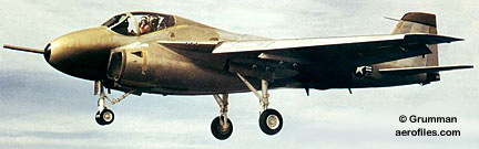

Which came first: the chicken or the egg? The Flap or the Flaperon?
One very simple reason .... Flaperons (spoilers) allow the use of longer flaps that extend the whole length of the wing. Helps reduce landing speed at the boat.
STOP THE PRESSES!!!
Actually, that is not quite the case here. The original "A-6" Intruder, the Grumman A2F, had a large-area mid-mounted wing of moderate sweep --- 25 degrees at quarter-chord. The wing had trailing-edge flaps that extended over almost the entire length of the wing, so conventional ailerons were not fitted. Lateral controls was provided at low speeds by the movements of the flaps (operating as "flaperons") and at high speeds by a series of spoilers mounted on the upper wing surface. The spoilers could be operated differentially for roll control in flight.
THE ORIGINAL UGLY, the Grumman A2F INTRUDER
Check with your friendly local Grummie Tech-Reps --- I did. They tracked the answer down with HQ in LA --- whatever happened to Bethpage, anyway?? As an aside, one particular TechRep was a pilot RAG instructor of mine in winter '71-'72 !!! He lives !!! The experience didn't kill him !!!
According to the Bible of Grumman: the flaperon/spoiler configuration provided two (2) primary functions in the A2F design:
1. The system provided more positive roll-rate control @ high gross weights --- especially with heavy (i.e., 28 Mk.82's) external stores.
2. The dual control surfaces had the added bonus of providing a lift-killing device for the high-lift wing after landing; AFTER TOUCHDOWN and spoiler deployment.
Lowering the landing speeds was a by-product; but it was not in the design concept. (says Grumman)
Another little known item in the great old girl's development ...
During its design process, Grumman considered several different configurations, including a turboprop-powered (!!!) straight-winged aircraft (decidedly much too close to a P-3) with twin fins and rudders as well as a pure jet-powered aircraft with turbojets mounted in pods underneath M-shaped wings, with forward swept inboard panels and swept-back outward panels. The design that Grumman finally settled on (named Design 128Q --- by the company) was a two-seat jet-powered aircraft.
