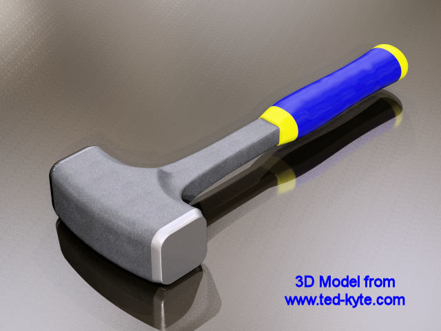

Can you approve a piece of gear, that looks like a 3 pound drilling hammer that I can use to modify T-45A's for more legroom (couple whacks in the "knee knockers" should do the trick).
:D
It stows in the T-45A Map Case. I already have checked that for fit.
