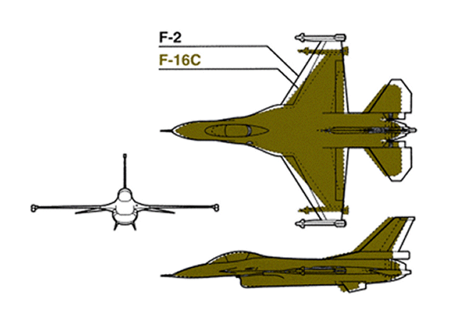

The F-2 is the JASDF's next Frontline Multi-role aircraft. Lockheed Martin does have a hand in the production of the aircraft, so the obvious resmblance is a question easily answered. Hell, F-16.net even counts it as an F-16 version, despite its separate designation...
the main differences are a much different profile of the LERXes and a greater wing area... the F-16's trailing edge is almost perpendicular to the A/C's centerline, where the F-2 has a slight forward sweep on its wings trailing edges...
here's a diagram of the two

*edit* Very interesting, what would the forward sweep do? It's apparent fromt he diagram that this version is longer, but why the wing sweep? Probably something to do with the aspect ratio I guess. Reducing drag maybe?

one benefit of forward sweep on the trailing edge has the effect of sweeping the 1/4-chord , or at least straitening it out a little. A forward swept 1/4-chord helps with aircraft stability (you can see this on air racers like nemesis), and some older fighters. Of course one of the benefits of the f-16 is that it is naturally unstable (corrected by feedback control and fly-by-wire) which makes the aircraft more manuverable.
