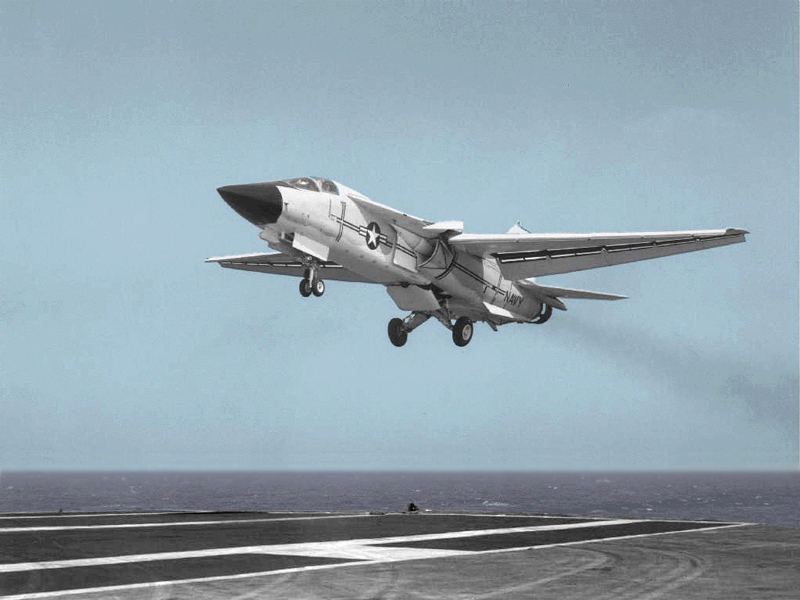

The F-111B was the Navy half of the TFX program (Tactical Fighter Experimental), designed to fill the role that the Tomcat eventually did. It was a MacNamara idea, and from what I have read it was vastly over budget and well overweight by the time this picture was taken:

As far as the first question, Admiral Zumwalt'sautobiography On Watch goes into extensive detail about the development of the F-14. The SECDEF originally wanted the Navy and the AF to use the same plane (F-111), but couldn't get the Navy to sign off on it due to carrier suitability issues. The Navy went with the F-14 design program using an inferior radar and engine set up to that of the F-111 (supposedly to cut costs of design), later causing extensive upgrades to create the F-14D models (which use similar engines and radar as the F-111 I think).
