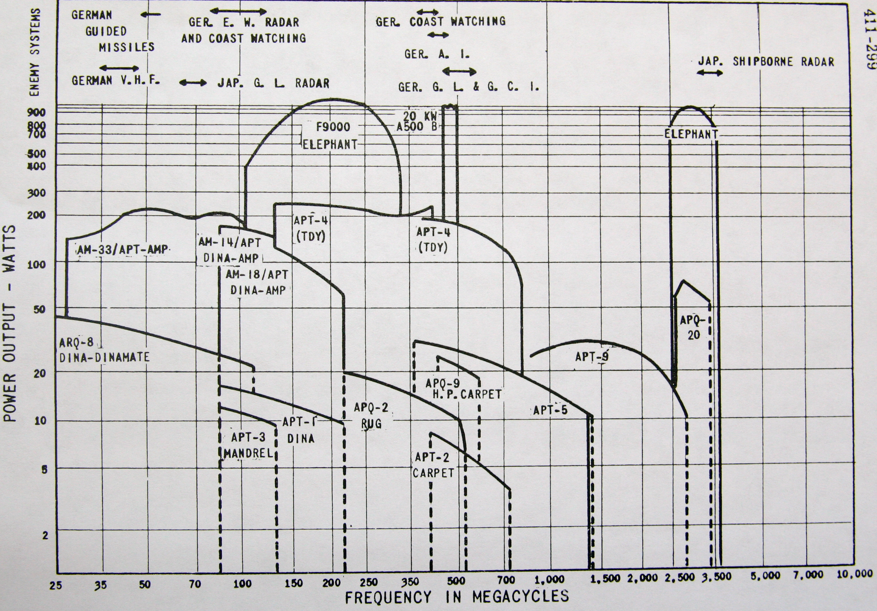

I also found this guy on the web that some of you VAQ guys may find historically interesting:
Fascinating. I guess the Hertz hadn't yet attained widespread acceptance in nerd-speak circles. Also interesting that the Germans stayed at the lower band of the spectrum, while the Js used the higher microwave region. Would have been cool to see some of the technical specs on this equipment. I read a really cool book years ago that talks about the history of U.S. carrier-based aviation, and it spends a good amount of time talking about the various electronic gadgets that were used and how radar/TACAN/ADF/Etc were first incorporated into tactical platforms.
