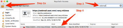

If you pick the wrong certificate and Safari won't bring up the certificate picker, use the following steps:
1) Quit Safari. Not just close windows, quit.
2) Launch Keychain Access.
2a) If necessary, click the padlock icon on the left side of the window and enter your admin password
3) Type in a word from the address of the site you're having trouble with. ("webmail" works for OWA, for instance.)
4) Select and delete the Identity Preference key(s).
That should do it.
