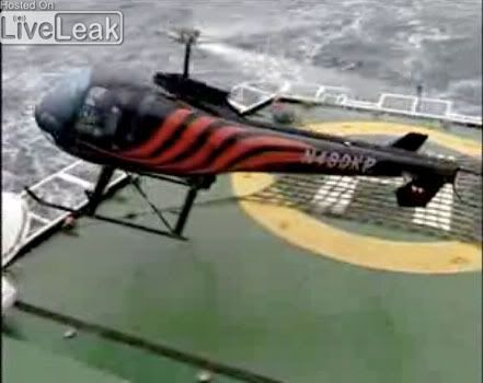

Yes, considering you cut your own tail rotor off....

WTF is with the cargo net on the deck that could cause any number of bad things. He never seemed to lose his tail rotor.

Watch it again closely...to me (and I'm a jet guy) it looks like he clipped his own tail rotor...you can see it (the tail rotor) spinning and flapping around. Maybe causng the rotation prior to setting it down (full off collective???). I got no idea what the heck I'm talking about now... :eek:
I'm guessing the nets were to make friction with the deck...sort of like wetting the wardroom tablecloth in heavy seas to keep the dishes from sliding.

It looks like he drifted forward because of the deck pitching, aft cyclic to correct the drift, smacked the stinger (tail rotor protector), then tail and started to spin. Lucky dude, lowered collective and stopped. Pure luck caught on tape.

I stand corrected, looks like he smashed his t/r and pulled a bunch of collective initially-bad reaction, there are no up collective emergencies.
As for the netting I agree that was the intent however hooking a skid toe or heel on landing or take off sets up a dynamic roll over situation and is more dangerous and likely than the natural sliding around on the deck, cant tell if they have nonskid on there or not but nonskid loses much of its helpfulness around month 3 or 4.
Never take off until someone shows you all the tie downs confirming that they are no longer on your aircraft.

Not negating the clown show reaction, but I wonder if someone either had a little too much forward cyclic and/or a touch of up collective and as the stern came down, the disc caught a bit of lift, sliding it forward. Then, as Skid mentioned, he pulled up. Very odd.
I'm w/ Schnugg on the cargo net. Probably some sort of half-assed non-skid.
