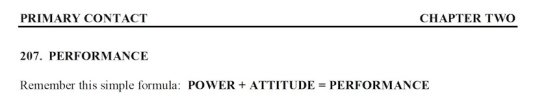

A lot of students tend to chase the amber doughnut with their nose, for obvious reasons (it does make it appear randomly). This drill was to reinforce that idea that Power + Attitude = Performance (is that still a thing in training?) I would get the stud set up long in the groove, on speed and on glideslope, and have him take his greasy unwashed glove and make a little smudge on the windscreen over the FLOLS, then give him the aircraft and tell him to just keep the smudge on the FLOLS, using only his power to control glideslope, and OBTW don't forget lineup. Forget AOA. In fact, I'd dim it so he couldn't see it. Just keep the smudge on the ball. I threatened to punch him/her in the back of the head so hard their significant other got contact CTE if they let it move.
