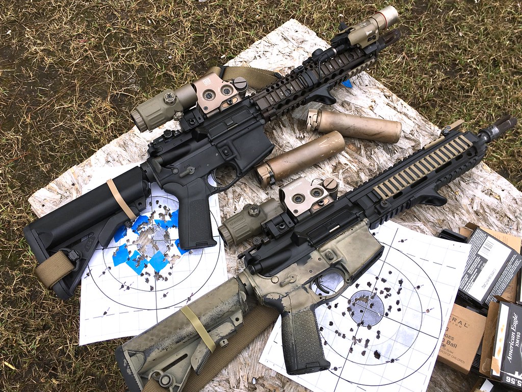

There's certainly some up front hassle getting into the NFA game, and a little bit more so now with 41F, but it's still not that bad and shooting suppressed or shooting an SBR is just such great fun. I mean don't tell me you wouldn't enjoy owning one of these!
