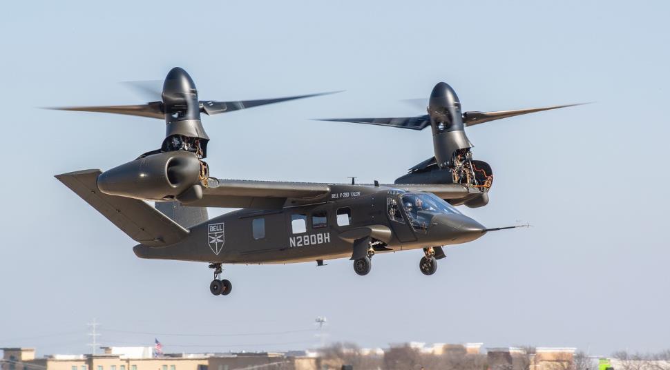

FVL seems to have become an umbrella program for all the services who are looking to replace their H-60s and H-1s in the coming decade or so. As the FVL program has gone on it seems like each service has developed or branched off their own specific requirements that include FARA (new Kiowa take 3?), AURA (h-1 replacement), and others (USN 60 replacement). The Defiant and V-280 are technology demonstrators for FVL that will result in a eventual replacement for USA 60s.

Not to thread jack, but has anyone else seen this? Seems like the Army wants an upgraded version of the V22 Osprey?
